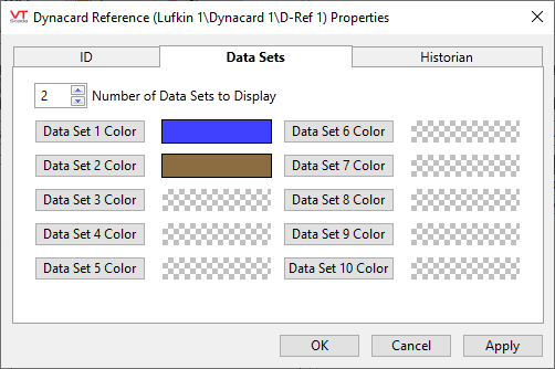

The Dynacard Reference tag allows you to store a particular data set from a Dynacard Input tag as a reference. For example, if you take a known good stroke as a reference, you can display that on the Dynagraph next to the current strokes on an ongoing basis. This allows you to see when the two Dynacard data sets are starting to diverge from one another. References are saved from the Dynacard Graph screen (Dynacard Display).
Dynacard Reference properties Data Sets tab
Number of Data Sets to Display
Choose how many to display, up to a maximum of 10.
Data Set X Color
Choose the color to be used by the matching data set.
