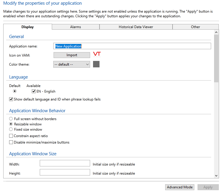

Basic Mode of the Edit Properties page
The Edit Properties page opens to a simplified view, where three tabs contain the most commonly used properties. You can access the full selection of properties at any time by clicking the Advanced Mode button at the lower right corner of the page.

The general steps to set a value for a property using the Application Configuration dialog are as follows:
  1. Open the Application Configuration dialog.
  2. Open the Edit Properties page.
  3. Find the property...
    1. The most commonly accessed properties can be found in one of the four tabs of the basic mode: Display, Alarms, Historical Data Viewer or Other.
    2. For other properties, click the Advanced Mode button to view a list of all. The list can be sorted by name, type, and value.
    3. Advanced Mode: If the property has not yet been set in the current application, copy it from the underlying OEM layer. OEM properties are shown in gray and have a check mark in the OEM column.
    4. If the property is not listed, click the Insert button to add it.
  4. Change the property's value.
  5. Apply the changes.
  6. Deploy the changes if Automatically deploy local changes is not selected in the "Other" tab of the basic mode.
