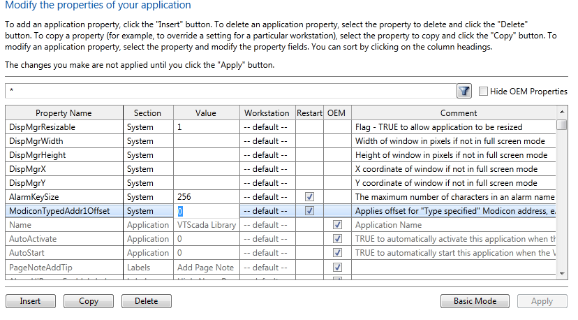

  1. Open the Edit Properties page of the Application Configuration dialog.
  2. Open the Advanced Mode.
  3. Find and select the property whose value you want to change. Only properties that are not flagged as OEM (and displayed in a pale gray color) may be edited.
  4. Click in the Value field.
An edit window will open within the field.
  1. Type a new value for the property and press Enter.
  2. Click on the Apply button.

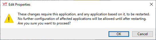

If the property is one that requires an application restart before it goes into effect, you will see the following warning:
  1. Click on OK unless you would like to make other configuration changes before proceeding with this one.

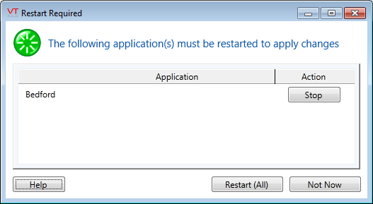

  1. If the property requires a re-start before it takes effect, you will see the following dialog. Choose whether to stop the application, restart now or restart later.
If you choose Not Now, the Restart Required symbol will be added to the application's title bar and further configuration changes will not be allowed. The buttons for the Idea Studio, Application Properties, Tag Browser and for Page Notes will be hidden.
