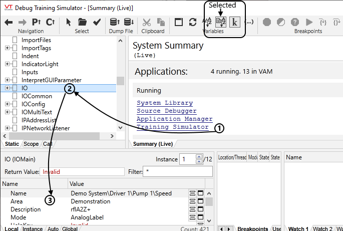

Use the Source Debugger to find tag properties:
The Source Debugger is a very powerful tool for examining applications
To find the names of properties within a tag, follow the numbers in the preceding figure. It will help if the Sort Tree tool is selected in the toolbar as indicated.
  1. Click to select the running application.
  2. This is the "static tree list". Find and select the tag type that you want to examine.
  3. This is the "module content window" with the "local" mode selected. Scroll to view the property names.
Names that begin with a symbol such as # or @ are for use only by VTScada. Never use these in any of your expressions.
The Source Debugger and other diagnostic tools have low-level access to running applications. This is part of the reason the Security Best Practices topic in the VTScada documentation advises you to keep the VAM hidden from unauthorized users while your application runs.
