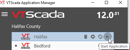

To start a VTScada application from the VAM (VTScada Application Manager):
Click once on the quick button beside the application's name. (If the quick button is not a triangle, you may need to expand the triple-dot menu to select Start Application.)
The Start Application button.
- Click the Start button.
- Double-clicking on the application name will also start the application.

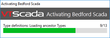

Activating an Application
Activation is a step towards running. In an activated application, the version control system and the security manager run, but there is no user interface, no I/O, no logging and no alarms.
Once an application has been activated, it will remain activated while VTScada continues to run. It is not re-activated when another event in the list occurs and there is no "deactivate" command.
An application is activated when any of the following occur:
- The application starts (either auto-start, or in response to an operator clicking the run button).
 - Any layer (application) that was built upon this one is activated.
 - A developer opens the Application Configuration dialog.
 - A developer chooses to remove the application from the VAM.
The "Activating" dialog is displayed for a few moments during the process.
The Activating dialog

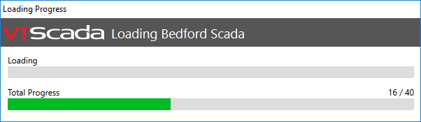

The Loading Dialog
A dialog box shows the progress of a loading application while it starts.
The Loading dialog
In the unlikely event that an application fails to complete the loading process, try to make a note of the last message and the progress indicator before calling Technical Support.
