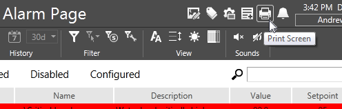

Alarm lists are alarm reports. Use the filtering and sorting tools to limit the display to only those alarms you are interested in seeing, then use the Print tool to send the list to your default system printer, or Ctrl-C to copy the list to the Windows clipboard for use elsewhere. The currently displayed list will be used in either case.
To print the current alarm list:
  1. If the Alarm Page is open as a full-screen page, click the printer icon at the upper right of the screen.
  1. Choose whether to send the list to the default printer, or to a printer file that can be copied to a printer at a later date.
If you chose Output to file, you will be prompted for a file name and location. Otherwise, the alarms will be sent to the default Windows system printer.
