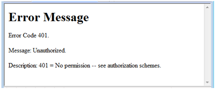

An example of an error response:

| 401 |
Any of:
Note:You may receive a 401 error code if no VTScada application is running (i.e. the VTScada Security Manager cannot authenticate against any user accounts), or if the application you are requesting is not running. |
