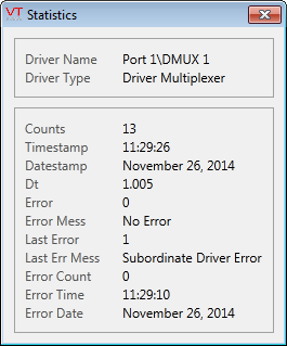

DriverMUX Statistics Dialog
The contents of this dialog will depend on the mode in which the DriverMUX is operating. If set to Alternating or Parallel, the contents will show statistics for the Driver Multiplexer, as follows.
In all other modes, the statistics will be for the selected subordinate driver.
Driver Name The name of the driver (within the driver's code) for which statistics are being displayed.
Counts The number of successful communications since the system started.
Timestamp The time of the last successful communication.
Date Stamp The date of the last successful communication.
dt The Response time - that is, the time between a request for information and the message being sent.
Error The error number (code) for the current error.
Error Mess A message describing the current error message for this driver.
Last Error The error number (code) for the last error that occurred.
Last Error Mess A message describing the type of communications error that last occurred.
Last Error Mode Identifies the mode in which the driver was operating at the time of the last error.
Error Count The number of errors that have occurred since the system started.
Error Time The time of the last reported error.
Error Date The date of the last reported error.
