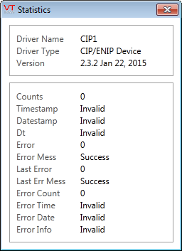

CIP Driver Statistics Dialog
The Show Stats button will display the following information about a CIP driver tag.
Driver Name The name of the driver (within the driver's code) for which statistics are being displayed.
Version The version number and date that this driver was created.
Counts The number of successful communications since the system started.
Timestamp The time of the last successful communication.
Date Stamp The date of the last successful communication.
dt The Response time - that is, the time between a request for information and the message being sent.
Error The error number (code) for the current error.
Error Mess A message describing the type of communications error that has occurred.
Last Error The error number (code) for the last error that occurred.
Last Error Mess The message describing the type of communications error that last occurred.
Error Count The number of errors that have occurred since the system started.
Error Time Time when the last error message was recorded.
Error Date Date when the last error message was recorded.
Error Info Further details regarding the message.
