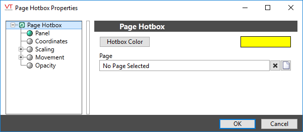

The properties dialog for the Page Hotbox widget:
Hotbox Color
While most developers will leave the default color in place for the sake of consistency, you might decide to color-code the hotboxes for various groups of pages in your application. You might also want to ensure that Page Hotboxes use a different color than Set Value Hotboxes, which are analog control widgets.
Page Name
Select the page to be opened when the operator clicks the hotbox.
Parameters
Visible only if the selected page has parameters. If so, it is important to select the tags and values that will be used for those parameters when the operator opens the page using this particular hotbox. Failing to do so will result in the operator being prompted for parameter values with every return visit.
Whether the page opens as a pop-up window or full screen, depends on the configuration of the page, and not on any configuration of the hotbox.
