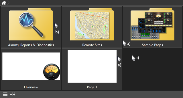

- Navigate to the Page Menu Page by clicking the VTScada logo at the top left of the screen.
- Navigate to the folder level where you want to add the page and right-click:
- To add the page at the current menu level, right-click on a page, on a blank square (if any) or on the narrow divider bar between folders.
- To add the page to a sub-folder, right-click on that folder.
Lettered arrows match options above.
- In the pop-up menu that opens, select New (page at current level) or New Child (page under selected folder).

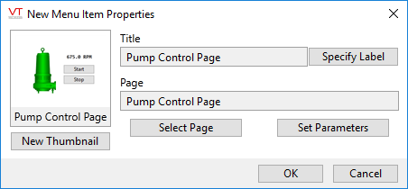

The New Menu Item Properties dialog opens. - Select Page.

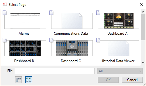

The Select Page dialog opens. - Click to choose the page to add.
The New Menu Item Properties dialog opens. - Reconfigure the menu item if required.
You might choose to change the title, or if this is a parameterized page, add parameters. - Click OK to finish.

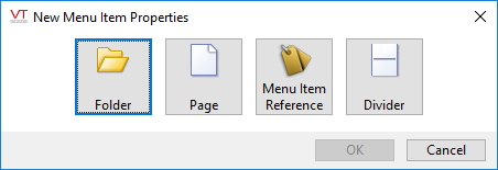

The steps to add a folder, divider or menu item reference are much the same, differing only in the dialog boxes and options along the way.
Displayed when adding a new entry of any type to the page menu.

Includes all pages to which you have security privileges.
Note the choice to display pages as a list or as thumbnail images (shown).
- Click to select the page option.
The Select Page dialog opens. - Select the page to add and click OK.
The New Menu Item Properties dialog now shows configuration options for a page. - Optionally, change the label, add parameter if this is a parameterized page, or select a different page.

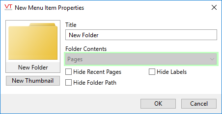

To add a folder, use the same steps as for adding a page menu entry. Configuration differs only as follows:
Select Folder rather than Page from the New Menu Item Properties dialog.
Title
Type a name for the folder
New Thumbnail
Select any image on your VTScada images collection. The default image measures 244 x 183 pixels, therefore an alternate image will display best if it is near to those dimensions.
Folder Contents
Filtered according to where in the menu tree the folder is added. The example shows "Pages", therefore this folder is being added below the Menus\Page Menu branch.
The following options exist only when a folder is being added to the Page Menu branch. They are not available in folders added to any of the palettes.
Hide Recent Pages:
Recently visited pages are displayed in a list across the top of the tiled menu, making it easy for operators to reopen commonly accessed pages. By hiding the list, you make more room available on screen for the pages shown within the folder.
Hide Labels:
The label is the name of the page, ordinarily shown below each page image in the folder view.
Hide Folder Path:
The folder path is the navigation bar, beginning with the home icon.

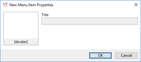

Add a divider to the menu
Dividers are visible only in the list version of the menu. They draw attention to menu items and help to separate one set of items from another. No configuration options are enabled.
