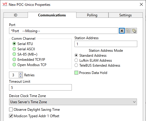

POC-Unico Communications properties tab
Port
Select the port tag, through which VTScada will communicate with this device.
Comm Channel
Select the communication channel and protocol to use for this Modbus Compatible Device driver. This will be one of:
- Serial RTU Select to use the RTU mode of the Modbus serial communications standard.
- Serial ASCII Select to use the ASCII mode of the Modbus serial communications standard.
- SA-85 (MB+) Select to use the Modbus Plus communications protocol via a Modicon SA-85 card.
- Embedded TCP/IP Select to use the Embedded TCP/IP protocol.
- Open Modbus TCP Select to use the Modicon Open Modbus/TCP specification to receive Modbus protocol over Ethernet TCP/IP.
Modbus Address
The station address of the Modicon programmable logic controller. By default, the PLC Address field is set to 1.
An expression may be used to provide the address if needed. This may be required on a network where the address varies depending on the workstation where the tag is running.
Note that, to create a valid expression for an address that contains non-numeric characters, you must enclose the address in quotation marks. e.g. "31.0.0.0" See: Modbus Plus PLC Addressing.
Time-Out Limit
Set the receiver time-out limit in seconds or fractions of a second. This is the length of time that this driver should wait for a reply from the PLC or RTU.
Modicon Typed Addr 1 Offset
Applies the offset for "Type specified" Modbus addresses.
"Type specified" means addresses such as the HC1 and IR2 format. This does not apply to addresses written as only numbers. (For example, 40001 is always the first address in the 40000 block, and is equivalent to HR1 when ModiconTypedAddr1Offset is 0, or HR0 when ModiconTypedAddr1Offset is 1)
Retries
Hold
Device Clock Time Zone
Select the time zone that the device uses in order to convert the time-stamped data from the device into UTC for storage in the VTScada historian. Regardless of the time zone selected with this option, the driver assumes that the device does NOT adjust its clock for daylight savings time (DST).
Defaults to the server's time zone, but may be set to use the device's clock if that is configured for UTC, otherwise any time zone where the device is located.
Observe Daylight Saving Time
Select if the RTU clock adjusts itself for Daylight Savings Time. Note that this does not necessarily mean that the RTU is in daylight savings time when this is being set. That is determined by the Windows operating system based on the selected time zone.

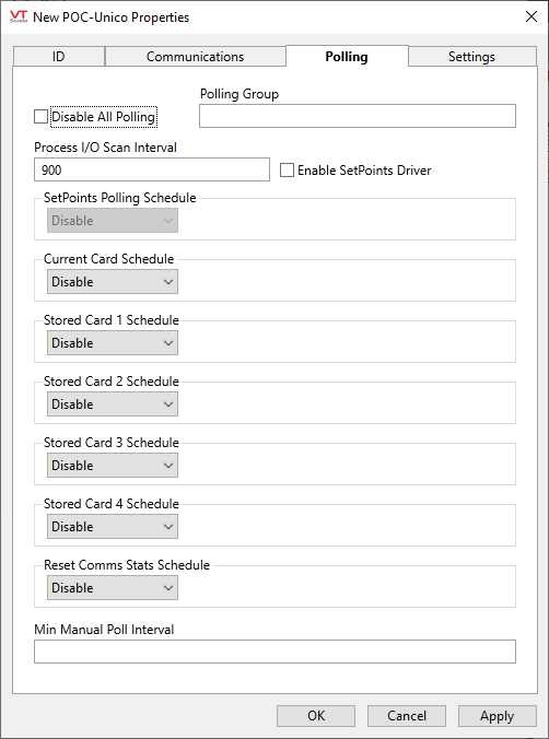

POC-Unico Polling properties tab
Disable All Polling
Select if communications are to be disabled at this site.
Polling Group
Provide a group name that will be used by the polling drivers within this tag. Groups ensure that polling drivers sharing a connection do not all try to poll at the same time. Each child Polling Driver will have its own sequence number within the group.
Useful only when two or more schedules match.
Process I/O Scan Interval
Measured in seconds, this sets the frequency at which process data is read.
Enable Setpoints Driver
If selected, tags in the \Process\Setpoints context will be polled using a dedicated setpoints driver instead of using the standard process driver. This allows the setpoints to be polled at a different rate from the other data.
Schedule Settings
Each polling schedule, when enabled, will offer a choice of "Hourly at", Daily, "Weekly on", or "Monthly on".
In each case, additional selections will be available, relevant to the overall scheduling of the poll.
Min Manual Poll Interval
Sets a minimum time between manual polls.

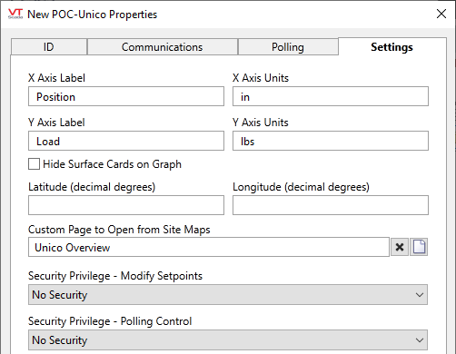

POC-Unico Settings properties tab
Labels and Units, X-Axis & Y-Axis
These are pre-configured with standard values, but you are free to provide your own labels and units to describe your system.
Hide Surface Cards on Graph
When selected, surface cards will not be shown.
Latitude and Longitude
Configure with the controller's location in order to display this site on a map.
Custom Page to Open from Site Maps
By default, the built-in Unico Overview page will open in response to an operator clicking on a site icon. You may create your own page, to use instead. Note that your custom page must be parameterized, taking a POC tag as its parameter.
Before selecting security privileges, you must first create those custom privileges. See: Protect Pages and Output Tags
Security Privilege - Modify Setpoints
Select the custom security privilege that you created in order to protect setpoints within this device.
Security Privilege - Polling Control
Select the custom security privilege that you created in order to protect polling control within this device.
