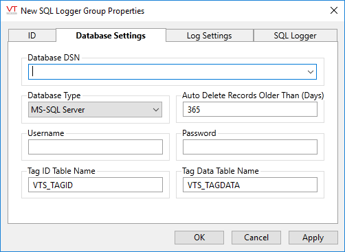

SQL Logger Group properties Settings tab
The Settings tab holds the properties required to connect this tag to a database.
Database DSN
As described in the introduction to this topic, you must create and configure a database before using the SQL Logger Group tag.
The DSN (Data Source Name) must already exist on your system and be pointing to the database you created for this tag.
Database Type
Tell VTScada what type of database you are writing to.
CAUTION: The Database Type selection MUST match your database. Choosing an incompatible type will result in the tag failing to write values to your database due to differences in data format.
Auto Delete Records Older Than (Days)
Username, Password
Tag ID Table Name, Tag Data Table Name

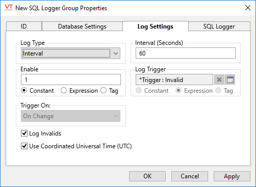

SQL Logger Group properties Log Settings tab
Contains options to configure the timing for when data will be written to the database.
There are three choices of Log Type: Interval, Triggered and On Data Change. Note that all the tags attached to a particular SQL Logger Group through the associated SQL Logger tags will use these settings.
Log Type
- "Interval" - Record values every (n) seconds. Use this when you want continuous monitoring of the system, setting the interval to the number of seconds you want between each data output.
- "Triggered" - Write values only when some condition changes. The write could be triggered by a tag changing value, or you can create an expression to define precise conditions that will cause a value to be written. Note that the trigger does not need to be activated by the same tag whose value you are recording. You could potentially record the level of a holding tank every time a pump switches on or off.
Trigger On
If you have chosen Triggered as the Log Type, you also have the choice of whether the trigger happens on a Value Change, a Rising Edge (from FALSE to TRUE) or a Falling Edge (from TRUE to FALSE. This applies to Constants, Expressions and Tags.
Log Type: On Data Change
This option for log triggering passes more control over to the Logger tags attached to this Logger Group. Essentially, you are indicating that log values are to be written when the value of the tag you are monitoring changes. See the section on the SQL Logger tags for more information.
If using this log type, please read the following section: Log Invalids for an important note.
Log Invalids
You have the option of whether to record "invalids" as part of the data being written. An invalid data value is essentially a NULL.
Note that if you select On Data Change as your trigger and you have not chosen to log invalids, then if the data changes from a valid value to invalid (or vice versa), no value will be written. You must enable Log Invalids to capture these data changes.
Enable
Where triggering controls the timing of data output, Enable sets whether data is to be output at all. Where the two controls offer the same options of "Constant", "Expression" and "Tag", the difference may seem subtle, but it is fundamentally different. Enabling the logger group means that logging is switched on or off. Triggering means that (if logging is enabled) data values are written when the trigger signals them to be.
If a SQL Logger Group is disabled, then all the SQL Logger tags attached to that group are automatically disabled.
Use Coordinated Universal Time (UTC)
A switch giving you the option to record the time stamp using either local time or UTC.

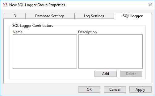

SQL Logger Group properties SQL Logger tab
Each Logger Group Tag must have one or more SQL Logger tags contributing data to it before it will be useful. As noted, the SQL Logger Group Tag creates a link to a database and sets a frequency of logging - it does not actually select what data is being logged. That job is assigned to the SQL Logger tag as described in the following section.
Only one widget is available to SQL Logger Group tags:
