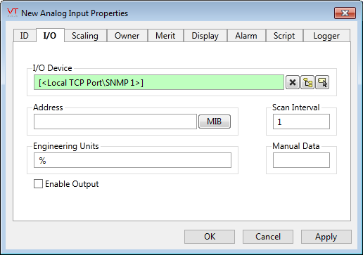

The following instructions assume that you are configuring an I/O tag that uses an SNMP driver and have reached the stage of building the address.
A MIB button can be found beside the address field when an SNMP driver has been selected as the I/O Device.

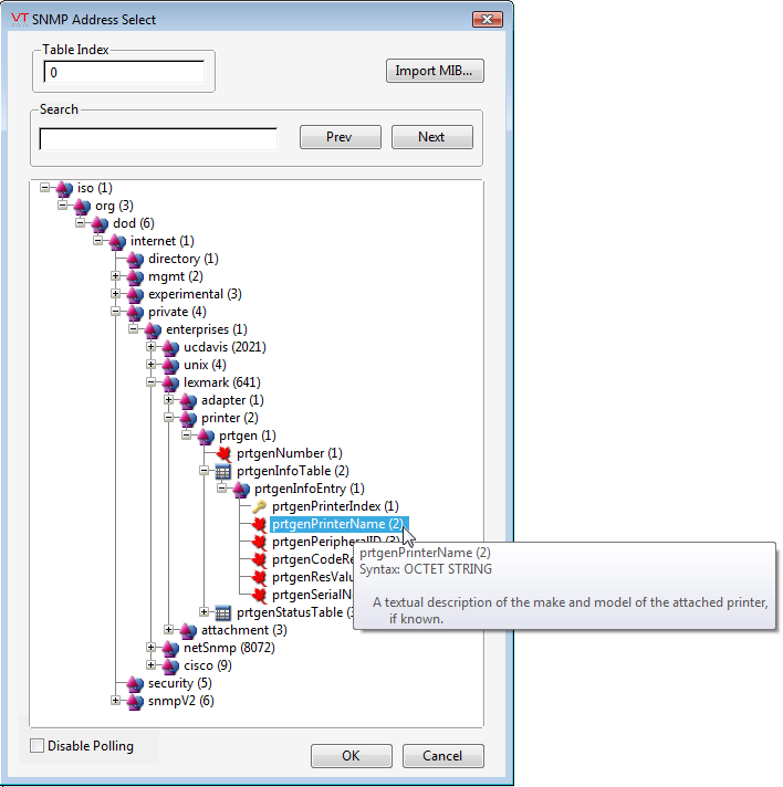

- Click on the MIB button.
- Navigate through the tree to select the device you wish to address.
Note that you can hover over a node to see extra information.
- If required, enter the Table Index number, specifying the row in the SNMP table.
The Table Index is the last number in the SNMP address string.
- Click OK.

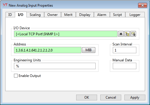

The Disable Polling option will turn off regular polls for this OID. Use this when you want to receive data from traps only. Adding the :NS (no scan) suffix after the SNMP OID will cause the same result.
The result will be similar to that shown here:
