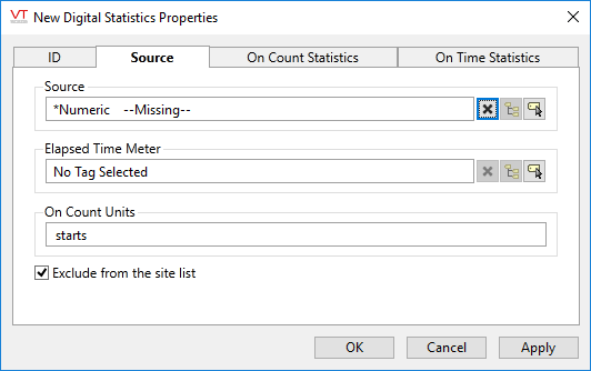

Digital Statistics properties Source tab
Used to select the source tag for which statistics are to be calculated.
Source
The Source tab is used to select which digital tag is to be monitored. Selection is limited to tags with numeric values, but only tags whose values have a clear zero to non-zero transition should be selected. Examples include Digital Input, Digital Status and Alarm tags.
Elapsed Time Meter
Your controller may be capable of recording the running time of the equipment being monitored. This is often called the Elapsed Time Meter. If your equipment supports this feature then an analog input (or analog status) tag can be created to read the value from the Elapsed Time Meter. You may then list this value beside the other statistics in your page graphics or reports.
On-Count Units
Similar to the Engineering Units field of analog tags, this value is used for display purposes only. Use it to describe what is being counted.
Exclude from Site List
Selected by default. You may choose to include this tag in the list of a Sites page as a folder. Operators may view a list of current statistics by clicking the link:

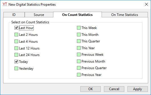

Digital Statistics properties On-Count Statistics tab
The On-Count Statistics tab is used to select the time frames for which you want to gather zero to non-zero transitions of the source tag. By default, only "Last Hour" and "Today" will be selected. Select all that you will need, remembering that a separate tag will be launched for each.
Note: Statistics for the time periods "this week" and "last week" are affected by the application property, StartOfWeek. You may use that property to set the beginning of a week to any day of your choice.
- "Today" means since the time 00:00 this day.
- "This Week" means since 00:00 of the first morning of the week.
- "This Month" means since 00:00 on the morning of the first day of the month.
- "Yesterday" means the 24 day, prior to today.
- "Last week" means the full week prior to the current week.
- "Last Month" means the calendar month prior to the current one.
- "Last 24 Hours" covers the 24 hours prior to "right now".

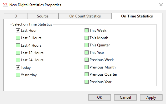

Digital Statistics properties On-Time Statistics tab
The On-Time Statistics tab is used to select the time frames for which you want to gather the non-zero (running) time of the source tag. By default, only "Last Hour" and "Today" will be selected. Select all that you will need, remembering that a separate tag will be launched for each.
