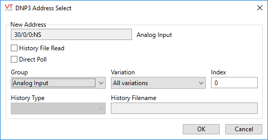

VTScada provides the DNP 3.0 Address Select dialog (Address Assist / Address Select) to help you build these addresses. In any tag that uses a DNP3 driver, the I/O panel of the configuration dialog will provide a button beside the Address field:
The Address Select will help you build an address, but you are not restricted by its available options. As long as the address field contains a valid, indexed address, VTScada will pass the data along. You can use the Address Select tool, or type out a known address manually, or start with the Address Select and modify the result.
Click this to open the Address Select dialog.
VTScada's DNP3 Address Select can auto-generate an object number representing tag type groups.
In the Group droplist, select the tag type group designation of your IO tags.
Available groups include:
- Binary Input
- Binary Output Status
- Counter
- Frozen Counter
- Analog Input
- Analog Output Status
- Time and Date
- Internal Indications
- Octet String
If the Direct Poll option is not selected, then (for the appropriate groups) the suffix :NS will be added to the address and no variations may be applied.
Click the Direct Poll option to allow scanning and to enable the Variation selector, the content of which will vary according to the selected Group.

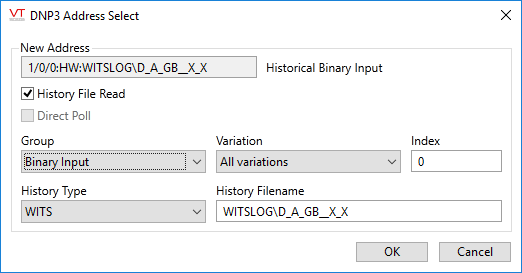

A History Read address takes the form G/V/INDEX:HW:FILENAME, where:
- G is the DNP3 "group", the supported groups are 1 (Binary Input), 10 (Binary Output status), 20 (Counter), 30 (Analog Input), and 40 (Analog Output Status).
- V is the DNP3 variation, for History Reads this should be 0 (all variations).
- INDEX is the point index.
- The ":H" suffix indicates a History Read.
- W is the history type, currently only WITS is supported so the type is "W".
- ":FILENAME" is the name of the history file to read. At time of writing, only the WITS global all points log file is supported. This has a filename of "WITSLOG\D_A_GB__X_X" which is the default.
An example of an actual WITS History Read address is:
"30/0/1:HW:WITSLOG\D_A_GB__X_X".
