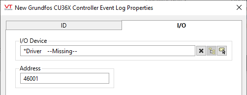

Grundfos Dedicated Controls Event Log: I/O tab
I/O Device
Will link to the parent Grundfos Dedicated Controls tag's polling driver.
Address
Defaults to 46001
