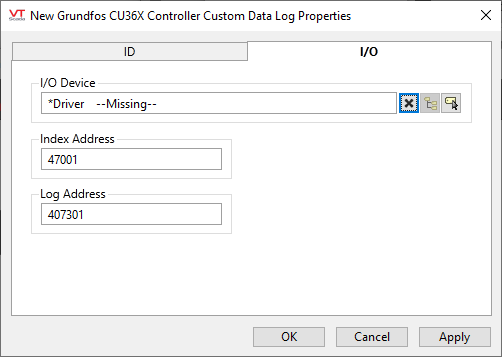

Grundfos Dedicated Controls Custom Data Log: I/O tab
I/O Device
Will link to the parent Grundfos Dedicated Controls tag's polling driver.
Index Address
Defaults to 47001, the address of the controller's index log.
Log Address
Defaults to 407301, the address of the controller's data log.
