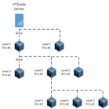

BSAP Serial Networks
The Bristol Driver can communicate with multi-level serial networks as shown in the following figure using the BSAP protocol option. For this network setups, create a single Bristol Network tag and a single port tag to represent the entire network and one Bristol Driver tag for each RTU.
BSAP serial network
For the example shown, the following tag tree will automatically implement the correct network and driver message routing. Note that each level of RTUs is nested below the node in the tag tree that acts as a store and forward node in the physical configuration.
Tag tree for the serial example

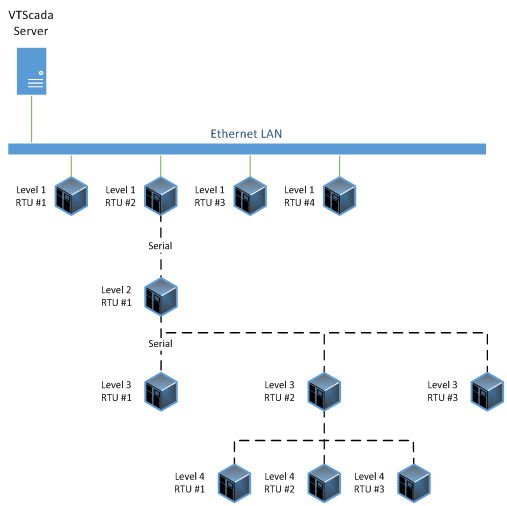

Mixed Networks
The Bristol Driver can communicate with RTUs connected to "mixed" Ethernet LAN/WAN and BSAP serial networks as shown in the following figure using the IBP protocol option. For this network setup, create a port tag and a Bristol Network tag for each Ethernet connected RTU, along with a Bristol Driver tag for each RTU regardless of how it’s connected.
Mixed IBP & BSAP
For the example shown, the following tag tree will automatically implement the correct network and driver message routing. Note the difference from the previous example – each Ethernet connected RTU still has its own Network tag but all RTU connected serially to that RTU use the same network tag.
Tag Tree for Mixed Example

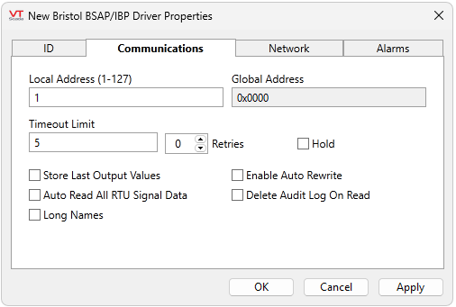

Local Address
Local address of the RTU (1 - 127).
Global Address
Global address of the RTU. This value calculated automatically by the driver based on the associated Network tag’s NRT and the position of the RTU in the network tree.
Timeout Limit (Data Read Time Limit)
The time limit in seconds to get a response from an RTU. This value will get progressively longer as the network nesting level of the RTU increases and must take into account the baud rates, the polling rates, the number of RTUs on the intervening networks, etc. For configurations with subordinate RTUs that have a "Non Master BSAP Poll Delay" (see the Network tab), you must take this delay into account. If the Timeout Limit is shorter than the poll delay, communications will timeout before subordinate RTUs have responded.
Refer to Bristol documentation for information on expected delay times to get responses to messages on multilevel networks.
Retries
The Retries field of this driver tag is obsolete and will not impact its functionality. If desired, the retry count should be specified within the field of the same name within a Bristol Network Tag linked to this driver.
Hold
Select this to have I/O tags attached to the driver hold their last value in the event of a communication failure. If not selected, tags will have their value set to invalid on a communication failure.
Store Last Output Values
Auto Read All RTU Signal Data
All communication between VTScada and Bristol RTUs is performed using the MSD numbers of the signals in the RTUs database. On initial startup, VTScada must communicate with the RTU to determine the MSD numbers for each signal to be read or written but by default only requests the MSD numbers for the specific signals that its interested in (i.e. the signals in the Input and Output tags). By selecting this option, the driver will automatically read all MSDs and signal names from the RTU whenever there is a request to read the needed MSD information. The data is then available for easy selection of the proper signals using the address picker tool on input and output tags for the driver. Note that this information is only read on an as needed basis – after it is read, it is stored to disk by VTScada and is still available on a system restart.
Long Names
Select when using ControlWave devices with firmware version 2.2 and higher to allow for longer tag names.
Enable Auto Rewrite
Delete Audit Log On Read
Select this flag to automatically delete the audit log entries from the RTU as they are read by the driver. By default, the log entries are not deleted and the driver keeps track of the last information read. The driver only reads the values that have been added to the audit log since the last read.

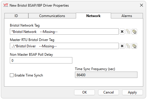

Bristol Network Tag
This is the Bristol Network tag that RTU is defined to be a part of. It can be defined explicitly as any Bristol Network tag configured in your tag configuration. If not defined explicitly, the driver will look up through the tag tree and use the first Bristol Network tag it finds as its network.
Master RTU Bristol Driver Tag
This is the Bristol Driver tag for the RTU that acts as the network master for this RTU. This tag is used by driver to determine its position in the network tree hierarchy and from that to calculate its global address.
The Master RTU can be defined explicitly as any Bristol Driver tag configured in your tag configuration. If not defined explicitly, the driver will look up through the tag tree and use the first Bristol Driver tag it finds as its Master RTU.
When configuring level 1 RTUs connected directly to the VTScada server with no intermediate RTUs, this tag must not be defined.
Applies to subordinate Bristol RTUs using the serial BSAP protocol only. This setting only applies to Bristol driver tags that are linked to a Master RTU Bristol Driver tag.
A time delay (in seconds) that the master RTU is required to wait to receive messages polled from the subordinate RTU. Defaults to 0 seconds.
If polls on the lower level RTU keep timing out without a data response then it is possible that VTScada is polling the master RTU too quickly. Setting a poll delay of 1 to 3 seconds may give the lower level RTUs the time needed to transmit the data message to the master.
If you have set a poll delay, you may have to increase the Timeout Limit (Communications tab) to accommodate this delay.
