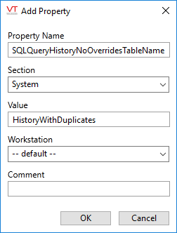

Multiple Values per Time Stamp
In most situations, if there are multiple values from one tag with the same time stamp, it is because duplicates were recorded, or values edited (Edit Data). VTScada will store all the values (each with its own sequence ID), but a query will return only the one with the largest sequence ID.
There are situations where different events can be logged to the same tag with an identical timestamp as provided by the I/O device. If this matches your situation, you can tell VTScada to return all the values for that timestamp by adding the property, SQLQueryHistoryNoOverridesTableName to your list of application properties and setting the value to a name you wish to use for the table in your queries.
If using this option, it usually will not make sense to query TPP values other than minimums or maximums. Add the property SQLQueryHistoryNoOverridesTableSupportsTPP as well, setting the value to FALSE to explicitly deny TTP value queries when retrieving duplicates.
