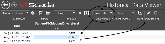

- Open the Historical Data Viewer, with one or more tags (pens) selected.
 - Switch to the grid view.
 - Ensure that the data mode is set to Raw Data. (A)
 - To change an existing entry or to add a new entry, select one row. (B)
To change a range of entries to a single new value, use the shift key to select several rows.
(Is it not possible to use the Ctrl key to select a random set of rows.) - Click the pen tool in the Data Editing tools. (C)

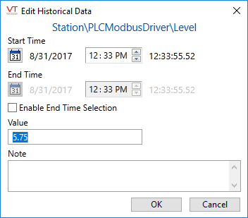

The Edit Historical Data dialog opens.
 - Provide a new value and enter a note for auditing purposes.
See following discussion relating to the use of Start Time and End Time. - Click OK.
The overridden value will be indicated by an exclamation mark (!) and a notebook symbol.
If there is a notebook symbol but no exclamation mark, then either the original value was restored or a note was added without changing the value.
To create a new record, change the Start Time in the Edit Historical Data dialog after opening. If Start Time matches an existing value, that value will be overridden. If there is no existing record for the specified Start Time, then a new record will be created.
As an alternative to selecting a range of rows in the grid, you can set both a Start Time and an End Time in the Edit Historical Data dialog. The result will be the same: all selected values / all values between the start and the end, will be overridden with the new value.
