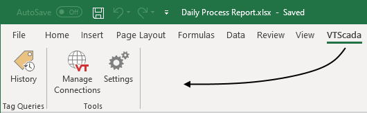

The VTScada toolbar within Excel

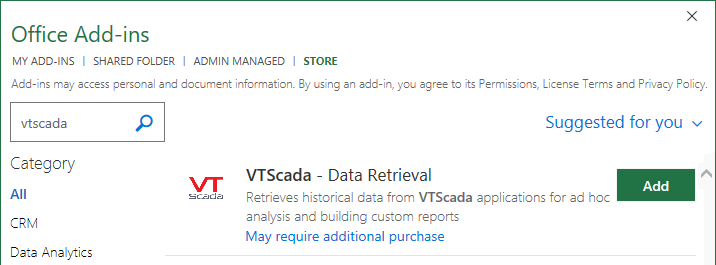

  1. In Excel, open the Insert ribbon.
  2. Select Get Add-ins.
  3. Select the Store option.
  4. Use the Search tool to find and select VTScada.
  5. Select the Add button.
Getting the add-in from the Office store.
