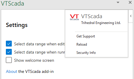

When each tool of the VTScada Add-in is opened, there will be a fly-out menu at the upper right. Use this to learn more about the tool.

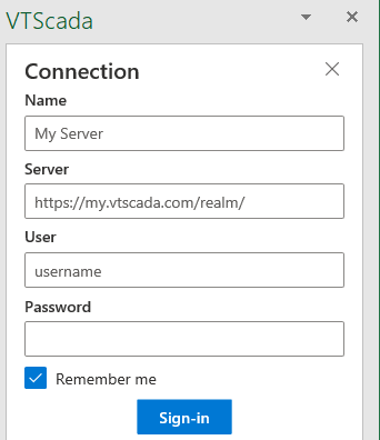

If you have not already created a connection in this workbook the Connection sub-panel opens automatically when you select the History tool. Otherwise, select New Connection.
The Connection panel.
Note the X in the upper right corner, which will close this sub-panel.
- Provide the following information:
- A name for the connection.
Any name may be used, but it may be helpful to create a connection name that matches the server name.- The URL for the server. This will typically include the realm name, where the application can be found.
This must use a secured connection. If you are using the standard port of 443, it need not be specified.- An account name for the VTScada application.
The account must have the Remote Data Access privilege.- The password for that account.
- Choose whether or not to remember the user name and password.
- Select Sign-in .
If successful(*), the connection name will be listed in the Connections panel. If you began the process by selecting the History tool, the Tag History Query panel will open immediately.

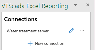

The Connections panel is available only after successfully creating a connection.
Use the Manage Connections tool to open.
Select the editing tool
to change the name, change the server address or to sign-out.
Within the expandable menu, you can also edit, as well as copy or delete the saved connection.
