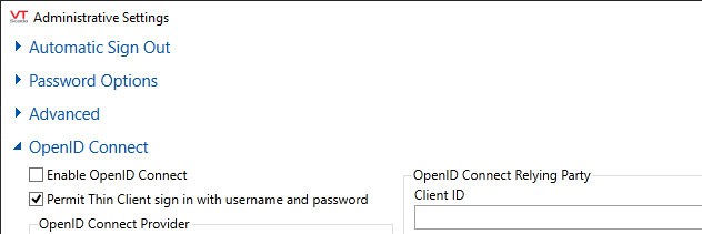

Assuming that you have a VTScada license permitting thin client (Internet) connections, the first step in configuring VTScada to allow thin client connections is to secure your site. Note that the following applies to all VTScada technologies that make use of the VTScada Thin Client Server.
At least one of Enable OpenID Connect or Permit Thin Client sign in with username and password, must be selected. If not, all Internet and Mobile sign in attempts will be met with the message "No sign in methods are available".
See also, OpenID Connect Authentication.
