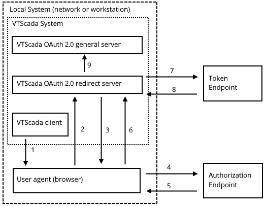

The OAuth 2.0 consent flow used by VTScada is the Authentication code flow. In this flow, a VTScada server will direct a user agent to the OAuth 2.0 provider authorization endpoint. Once the resource owner is successfully authenticated, the OAuth 2.0 provider authorization endpoint will redirect the user agent to the VTScada server with a single use code. This code can then be exchanged by the VTScada server for a pair of tokens by providing it to the OAuth 2.0 provider token endpoint. These tokens can then be used by VTScada to access to the resource for which the resource owner granted consent. Continued use of the resource by VTScada for services such as the alarm email system require a refresh token.
In order to authenticate the user agent with the VTScada server, a VTScada client will first direct the user agent to the server. At this point, the server will establish information required to protect the different elements of the OAuth 2.0 consent flow when communicating with the OAuth 2.0 provider. This is an additional step prior to beginning the general OAuth 2.0 consent flow.
The consent flow process. Numbers refer to the following steps...
  1. VTScada client invokes the user agent.
  2. The user agent is directed to the VTScada OAuth 2.0 redirect server to establish common identifying information.
  3. The user agent is redirected to the OAuth 2.0 provider’s authorization endpoint.
  4. The user agent contacts the authorization endpoint and authenticates the resource owner.
  5. The authorization endpoint redirects the user agent to the VTScada OAuth 2.0 redirect server with the single use code.
  6. The user agent provides the VTScada OAuth 2.0 redirect server with the code.
  7. The VTScada OAuth 2.0 redirect server contacts the OAuth 2.0 provider token endpoint with the single use code.
  8. The token endpoint responds with the appropriate tokens.
  9. The VTScada OAuth 2.0 redirect server passes the acquired tokens to the primary server for the OAuth 2.0 implementation. This may be the same server as that handling the OAuth 2.0 redirect.
