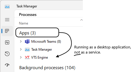

If you have been running VTScada as an interactive program, it is necessary to install the service objects before you can run the program as a service. You can do this using command line switches, or you may choose to repeat the full installation, selecting the service option.
Use caution if switching VTScada between running as a service and running as an interactive program. Problems will occur if your user account does not have the same permissions as the one under which VTScada runs as a service. If only one account has access to the Data folder or sets elevated permissions on the files it creates, these problems may be severe.

The application that will be available through your VTScada service must exist on the server, and be configured to auto-start. Because VTScada cannot run as a service and as an interactive program at the same time on the same workstation, the following procedure is suggested.
- Install VTScada and run as an interactive program.
- Create or install the application.
- Configure the VTScada Thin Client Server, to allow VTScada Thin Client connections.
- Configure the application to auto-start.
- Configure the VAM as described in Access the VAM from a Thin Client.
- Stop the interactive VTScada session.
- Run VTScada as a service, re-installing to add the service components if this was not done earlier.
The command-line syntax is recommended. - Start the VTScada service.
