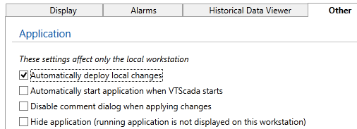

Workstation-specific properties in the Application Configuration dialog, Other tab
You can create a workstation-specific version of any property, not just the four shown here. Workstation-specific properties are stored in a file named after the workstation where they will apply and having an extension of either .Startup or .Dynamic. These are located in the WorkstationSettings sub-folder of your application.

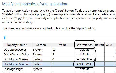

In this example, the setting for the variable, DispMgrFullScreen will apply only to the VTScada installation running on the workstation, ANDREWH. (DispMgrResizable must also be set to 0.)
Workstation-specific properties are stored in files named after the workstation to which they apply. For the example given, there will be a file named, "ANDREWH.Dynamic" in the sub-folder, "WorkstationSettings". (C:\VTScada\BedfordScada\WorkstationSettings\ANDREWH.Dynamic")
