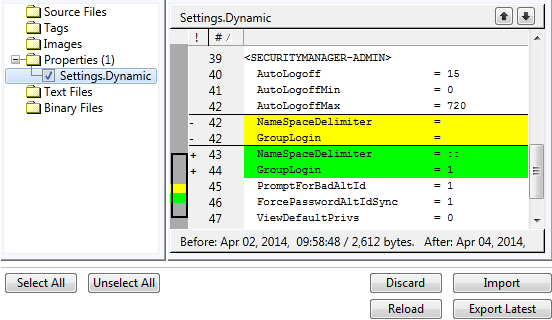

Before using the Import File Changes button in the VAM, you are advised to review those changes by using the Import/Export Files page of the Application Properties dialog.
Current (unchanged in code) values shown in yellow. New (not yet imported) values shown in green.
