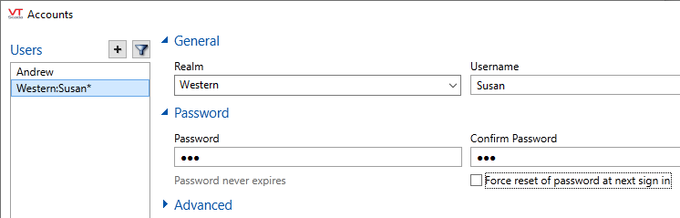

The NameSpaceDelimiter application property enables you to specify the character (or characters) you wish to be used by managers setting up security groups. The recommended characters for NameSpaceDelimiter are two colons, however, you may use any characters you deem appropriate. The assigned character (or characters) must then separate the name of the security group from the username of the user belonging to that group when a new security account is added to your application.
The following image displays the Add Account security dialog when a group is being specified for a new user. As you can see from this example, a colon has been assigned as the NameSpaceDelimiter.

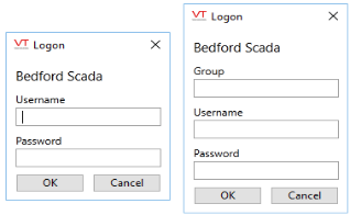

GroupLogin
The GroupLogin application property enables you to add a third field to the Sign in dialog that opens when the Sign in button in the Display Manager's title bar is clicked. This third field is the Group field, which enables users to specify the group to which their user account belongs when they logon to an application. To include the Group field in the Sign in dialog, you must set GroupLogin to 1.
The following image on the left displays the Sign in dialog when GroupLogin has been set to 0 (its default value), while the following image on the right displays the Sign in dialog when GroupLogin has been set to 1.
When signing in, users must enter the name of the security group to which they have been assigned in the Group field.
A super user (one who has not been assigned to any group) may leave the Group field blank, and can logon as they normally would, by entering their username in the Username field, and their password in the Password field.
