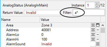

Filter Data in the Module Content Window
You to filter the variable list being displayed in the module content window as follows. Note that the filter refers to variable names, not values.
- Enter a filtering condition in the Filter field in the module content window.
(e.g. To view all variables whose name begins with "a" you could enter a*). - Press the Enter key.
The module content window will display only those objects that meet the filtering condition.
To clear the filter, enter * in the Filter field and press the Enter key.

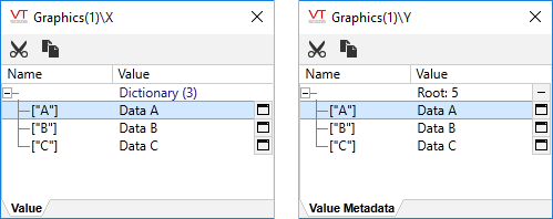

A value in VTScada has properties, other than just its value. By resting the mouse pointer over a value in the module content window, a tool tip window is displayed for several seconds, listing the properties of the selected value. For example:
The rules for how dictionaries are displayed in the module window can be confusing to new users. The following example may help:
Given the following code that creates two dictionaries, where the first has no root value and the second has a root value of 5:
If Watch(1);
X = Dictionary();
X["A"] = "Data A";
X["B"] = "Data B";
X["C"] = "Data C";
Y = Dictionary(1, 5);
Y["A"] = "Data A";
Y["B"] = "Data B";
Y["C"] = "Data C";
The module content window will look like the following:
Hovering over each of the variables in turn will produce tool tips as shown next:
Note that only Y, which has a root value as well as metadata gets a metadata button.
X gets the Window button, which in this case performs a somewhat similar function…

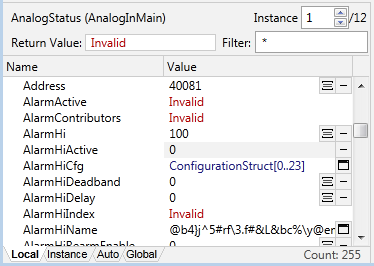

Tabs:
Local:
Displays only the variables and values that are local to the selected object or module. Values from parent modules that may be within the scope of the selected module are not shown.
Instance:
If a module has retained variables (which are persisted, instance-specific variables) and those variables have are valid values, then these will be displayed in the Instance tab. As you cycle through the instances with the "Instance" spinbox, any different values are displayed.
Auto:
Referring to the Code Display window, this tab shows variables and values near the selected line of source code. (Near is defined as one source code line before and one after the selected one.) This is most useful when single-stepping through lines of code. Values are refreshed automatically as you step through the code.
Global:
Shows all variables and values within the scope of the selected object or module.
