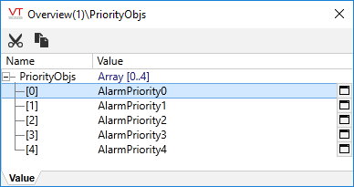

If the above were to be added to any page (and the two variables declared), then in the Source Debugger you could examine that page module to find the array of PriorityObjs:
Result of the preceding code example
