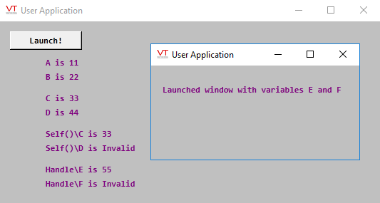

Protected Variables
On occasion, it may be necessary to limit access to certain variables, preventing access by code outside the variables' scope. This is done by prefacing the variable declaration with the keyword "Protected".
Protected variables (and modules) are not accessible through scope resolution. To put that another way, any variable that is accessible without scope resolution remains accessible, whether protected or not. All use of scope resolution to access a protected variable will fail, even if that variable is accessible without the use of scope resolution. Scope resolution refers to the function, Scope() and the operators "\" and "."

After clicking the Launch! button, the windows will display the following:
Image trimmed to fit this page
