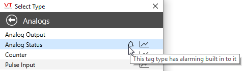

If the tag has a built-in alarm, that fact should be reflected as an icon in the Tag Browser.
To achieve this, all that is required is to add the following constant declaration. The Tag Browser will take care of the rest.
Constant BuiltInAlarm = TRUE { Flag - TRUE if this tag has a built in alarm };
