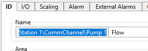

You can copy the hierarchy of a tag's name from its properties dialog. Highlight the hierarchy and press Ctrl-C. (Right-clicking to open a dialog for copy/paste won't work.)
Copying the hierarchy of a tag name
You can also use an expression in the Help ID field to obtain the full name:
Copying the full tag name, from the expression, NAME

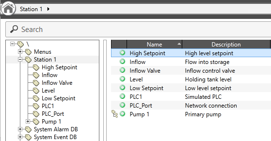

If the tag isn't nearby in the hierarchy, you will need to tell VTScada where to find it.

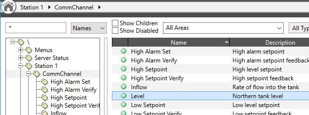

For example, given the following tag structure:
Expression to be created in \Station 1\CommChannel using Level
If you are creating an expression in a tag that's a child of CommChannel and that uses the value of Level, you would write it as [Level], as shown:
[Level] * 2 / 3 ; two thirds of the value
If you want to refer to a tag that is not an immediate sibling in the tag hierarchy, you will need to provide the address for where to find it.
Let's say that there is also a Station 2 with a level, and you want SiteCalc to show the average of the two:
([Level] + [Station 2\CommChannel\Level]) / 2 ; the average of two tank values.
Level within Station 1 can be found just by its name, but you must provide a path to the tag named Level in Station 2.
