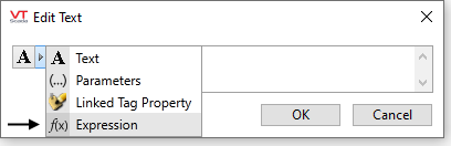

You can use the MultiText widget to display a message that varies according to a changing value. But, what if it also makes a difference whether equipment is running or an alarm is active? Further, what if you want the text of the message to include data calculated from two or more other tags? For this, you're going to need an expression.
- Open the Idea Studio.
- Working on the Overview or Station Status page, draw text (plain text from the ribbon, not a text widget) on the page.
- Open the Edit Text dialog and change the data source to Expression.
- Create an expression so that when the Level value is more than 50%, the message is "Level exceeds safe amount". When the Level is less than 50% the message should be "Safe level".
- [Optional] Adjust the message to tell your operators the percentage by which the level exceeds the safe amount.
