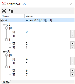

Multi-dimensional array:
A = New(3, 0, 2);
{ A is an array of two elements, each of which is an array of two elements, which in turn are arrays of two elements }
A[0][0][0] = 0;
A[0][0][1] = 1;
A[0][1][0] = 2;
A[0][1][1] = 3;
A[1][0][0] = 4;
A[1][0][1] = 5;
A[1][1][0] = 6;
A[1][1][1] = 7;
