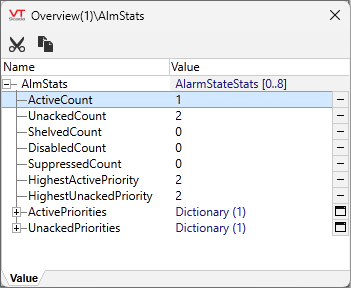

The return structure includes the following elements: ActiveCount { Total Active alarms including descendents };
UnackedCount { Total Unacked alarms including descendents };
ShelvedCount { Total Shelved alarms including descendents };
DisabledCount { Total Disabled alarms including descendents };
HighestActivePriority { Highest priority of active alarms including descendents };
HighestUnackedPriority { Highest priority of unacked alarms including descendents };
ActivePriorities { Dictionary of counts of active alarms for each priority, including descendents };
UnackedPriorities { Dictionary of counts of unacked alarms for each priority, including descendents }
The dictionaries, ActivePriorities and UnackedPriorities are keyed by alarm priority numbers, which are padded with zeros. For example, the key to access the count of Critical active alarms is "0001". |
