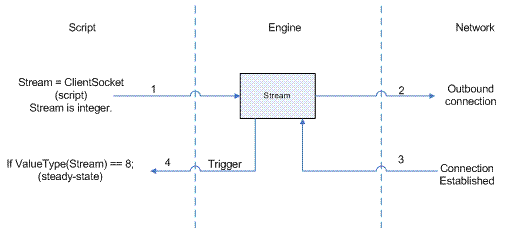

The client socket function has a slightly different behavior, depending on whether the connection is made via TCP or UDP. The difference is explained in the following two diagrams.
Client Sockets on TCP:
- A ClientSocket statement runs and returns an integer value.
- An outbound connection is made.
- When the connection is established, the stream is triggered.
- The stream trigger causes the value returned from 1 to become a stream value.
- If the connection attempt fails at any point, the value returned from 1 will become a negative integer, representing an error code

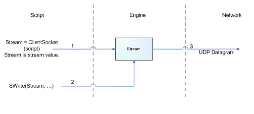

Client Sockets on UDP:
- A ClientSocket statement runs and returns a stream value.
- Stream writing statements are used to write data to the stream
- A UDP datagram is issued to the target device each time a write is done by script code.
