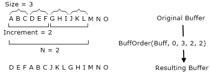

Format: ![]() |
BuffOrder(Buffer, Offset, Size, Increment, N) |
| Parameters: |
| Buffer |
| Required. Any text or buffer expression to be reordered. |
| Offset |
| Required. Any numeric expression giving the initial position within the buffer for the ordering, starting at 0. Offset must be greater than or equal to 0. |
| Size |
| Required. Any numeric expression greater than 0, giving the size of each group of bytes. Bytes within a group will remain in their original order. The portion of the original buffer that will be re-ordered must be evenly divisible into groups of Size. |
| Increment |
| Required. Any numeric expression greater than 0, giving the number of groups of Size bytes to be reordered. Re-ordering is done to the Size-groups within Increments, not across Increments. |
| N |
| Required. Any numeric expression giving the total number of Increment-groups to reverse. |
Comments:
BuffOrder is part of the driver toolkit. The return value is a buffer containing all bytes specified in the Buffer parameter with groups of bytes reversed. Offset + Size * Increment * N must be no greater than the length of Buffer. Returns Invalid if any parameter does not meet its requirements.
