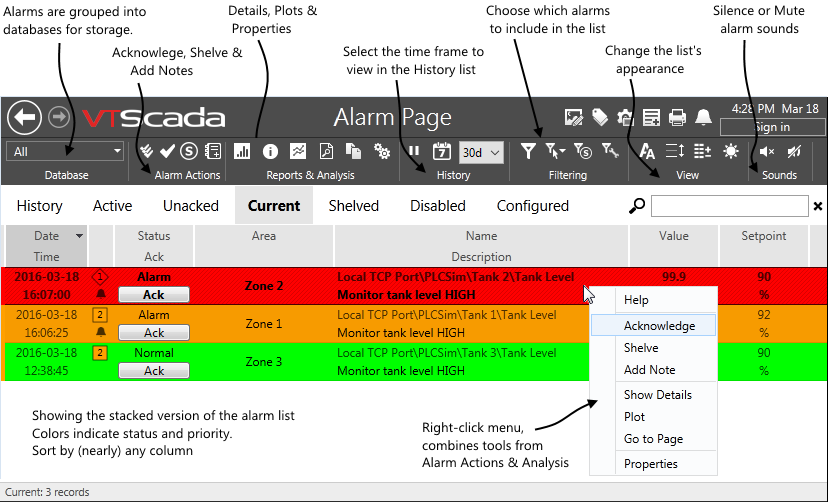

Highlights from the VTScada Alarm page. Appearance may vary.
Alarm lists can be configured. Yours may not match this image.
The list can be filtered and sorted as needed. Alarms may be acknowledged using the buttons in the Alarm Actions section of the ribbon, but in most cases, it will be easier to use the button provided within the list for each alarm. A right-click on any alarm opens a context menu of controls. In particular, you may find the Plot and the Go To Page entries to be especially useful.
