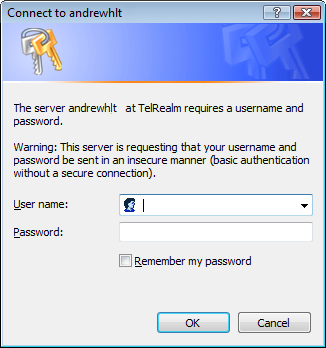

  1. When prompted, enter your account name and password.

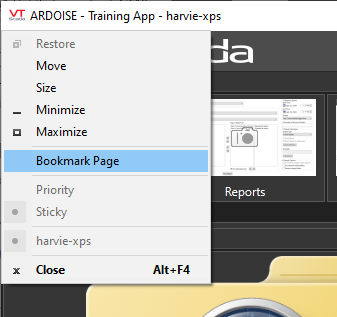

Create a Shortcut
  1. Select Internet Explorer's system menu (upper left of the screen).
  2. Select Bookmark
  3. Save the bookmark to your desktop or other preferred location.
The bookmark will be saved as a shortcut file (*.LNK)

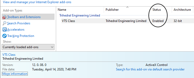

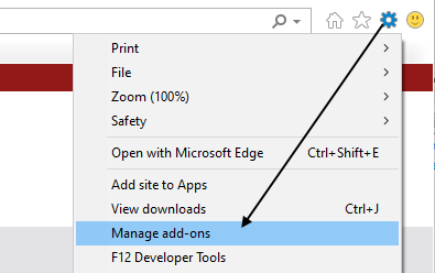

Check that the add-in is enabled:
Open the Manage add-ons dialog from Internet Explorer
Enable the VT Class add-on
