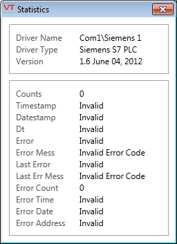

Siemens S7 Driver Statistics Dialog
The Show Stats button will display the following information about a Siemens S7 driver tag.
Stats For The name of the station for which the statistics are displayed.
Success Count Displays a count of successfully transmitted messages.
Timestamp Displays the time of the last successful communication.
dt The Response time - that is, the time between a request for information and the message being sent.
Response Time The time it takes the PLC/RTU to receive a command, process it and send a response.
Error Mess Describes the type of communications error that has occurred.
Failed Count Incremented on each error.
Error Address If an address was associated with the error, it will be recorded here.
