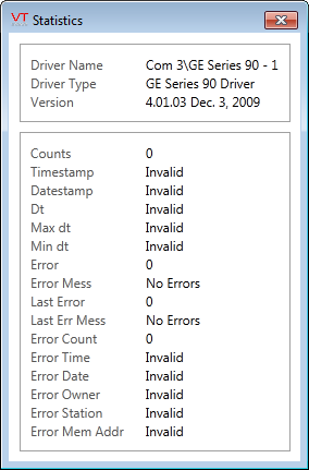

GE Series 90 Driver Statistics Dialog
The Show Stats button will display the following information about a GE Series 90 driver tag.
Driver Name The name of the driver (within the driver's code) for which statistics are being displayed.
Driver Type Identifies the driver.
Version The version number and date that this driver was created.
Counts The number of successful communications since the system started.
Timestamp The time of the last successful communication.
Date Stamp The date of the last successful communication.
dt The Response time - that is, the time between a request for information and the message being sent.
Error The error number (code) for the current error.
Error Mess A message describing the type of communications error that has occurred.
Last Error The error number (code) for the last error that occurred.
Last Error Mess A message describing the type of communications error that last occurred.
Error Count The number of errors that have occurred since the system started.
Error Time The time of the last reported error.
Error Date The date of the last reported error.
Error Owner The address at which the last error occurred.
Error Station The address of the station at which the last error occurred.
Error Mem Addr
