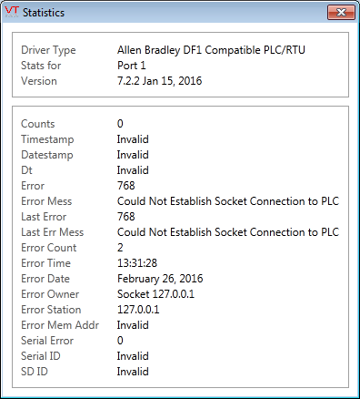

Allen-Bradley  Statistics Dialog
                                        The Show Stats button will display the following information about an DriverMUX tag.
Stats For The name of the station for which the statistics are displayed.
dt The Response time - that is, the time between a request for information and the message being sent.
Error Owner The address at which the last error occurred.
Error Station The address of the station at which the last error occurred.
Error Mem Addr The PLC address at which the last error occurred.
Serial Error The error number (code) for the serial error (if one has occurred).
Serial ID The ID of the serial error.
SD ID The ID of the KT/SD board, if one has been installed for this I/O device.
