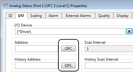

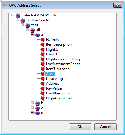

Clicking the OPC button opens the OPC Address Select tool. (Example shows a client connected to the Trihedral OPC Server - your display will vary depending on the server that your OPC Client is using. )
Using the Address Select tool, you can quickly navigate through the nodes to the OPC item that you wish to use.
For the VTScada OPC Server, there is no leaf for the "Value" of a tag. The tag node itself has the value attached.
