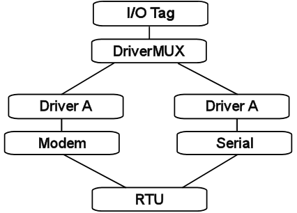

Scenario 1: Two lines of communication are set up between a PLC in the field and VTScada: one uses radio and the other uses a modem.
In this case, tag addressing is simple: The address is defined by the PLC device and does not change with the communication driver.

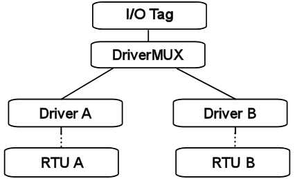

Scenario 2: Connecting to different RTUs.
For this scenario, the tag addressing used by the primary driver will be different from that used by the secondary. By way of example, perhaps one used Allen Bradley equipment and the other uses Modicon.
In this case, an I/O Tag will have to reference its intended data location by two completely different addresses. The address parameter of the I/O tag must therefore contain both addresses where each address is given inside curly braces and are given in the order of the Primary and Secondary subordinate drivers.
If (and only if) the DriverMUX is in Parallel or Alternating mode, you can make use of this address format to force an I/O tag to read from only one of the two drivers. Include both sets of braces, but leave the address blank for the driver that you do not want to read from.
Ex. {Primary Address}{Secondary Address}

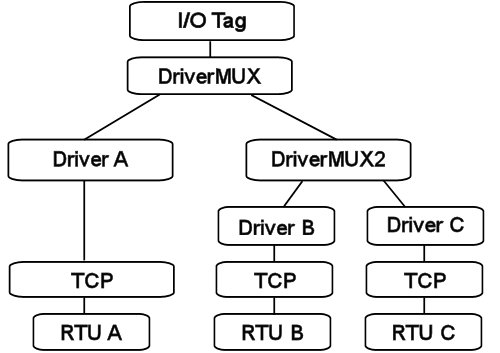

Scenario 3: A subordinate driver is also a DriverMUX tag, and each driver requires a different address for the I/O devices.
In this scenario, the addresses in each I/O tag will be nested in curly braces where the left to right order matches the primary to secondary configuration of the DriverMUX configuration:
The subordinate DriverMUX should never be configured as the preferred driver1.
Ex. {Primary Address}{{Secondary Address}{Tertiary Address}}
When the need arises to get a value from a specific driver (for example, the battery level of "C") you can ensure the DriverMUX tags do not poll this value from the other drivers by providing empty braces. To get the value only from "B" using the tag layout in scenario 2, the address can be set to something like {}{BatteryAddress}.
For scenario 3, it would be a little more complex: {}{{BatteryAddress}{}} for "B". {BatteryAddress}{{}{}} for "A".
