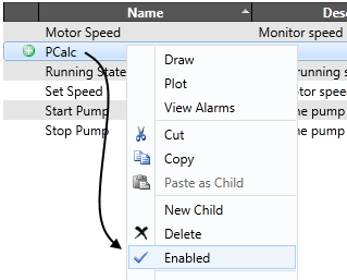

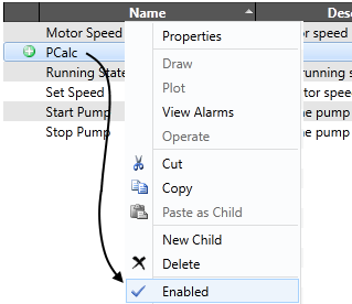

To disable a tag, right-click on it and click to remove the check mark from the line, "Enabled".
Enable or disable a tag
You might choose to disable a tag if you do not intend to use it for a period of time, but you do expect to use it again, or you will need access to it's logged data and therefore do not want to delete it.

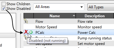

You can view disabled tags by selecting the Show Disabled option in the Tag Browser.
Show disabled tags
