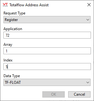

Totalflow Address Assist
Addresses can be more easily configured by the SCADA administrator by using the Totalflow Address Assist feature when configuring the telemetry address.
Configuration fields will vary according to the Register Type you select.
