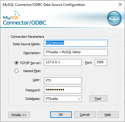

Connecting to a MySQL database.
A database named 'vtscada' has been created.
A user named 'VTS' has been created.
'VTS' has been granted CREATE and WRITE privileges on 'vtscada'.
The ODBC connection is created as shown. The user and password are for the MySQL database, not a VTScada account.
Sample DSN creation, using the MySQL connector within the Microsoft ODBC Administrator tool.

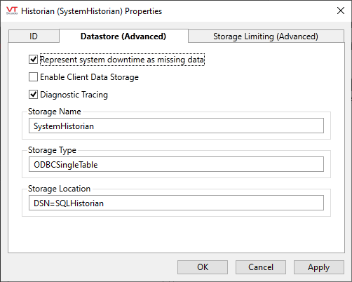

The VTScada System Historian is configured as follows:
The storage type is ODBCSingleTable for ease of data access.
The DSN matches the previous example image.
When using ODBC Historians, it is suggested that you specify the Storage Name parameter. This will be used as the schema name in the database. If left blank, the unique id of the Historian tag will be used as the schema name rather than its short name. Note that the unique id's length and complexity may cause difficult for some database programs.
The Storage Name must be unique for each Historian.

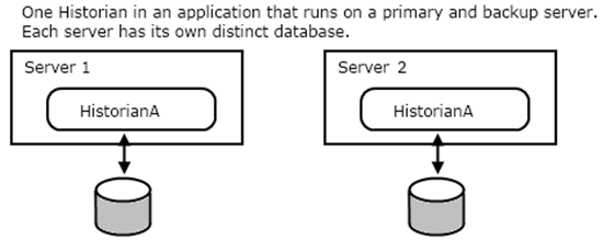

One Historian with two separate databases
To record to both the VTScada data store and a third party ODBC database, or to save to the C: drive on one machine and the D: drive on another, there must be at least two VTScada workstations in your system. You can then configure the Historian tags using parameter expressions that use a different configuration on each workstation. In the following examples, "SQLBackup" is the name of the computer where the ODBC database is installed. Parameter Expressions are added to the configuration fields of the Datastore tab of the System Historian as follows. These expressions check the workstation name using "WkStaInfo(0)", and configure for the ODBC database if the workstation is SQLBackup, or use default settings otherwise, by returning "Invalid". Note that the test for workstation name is case-sensitive.
