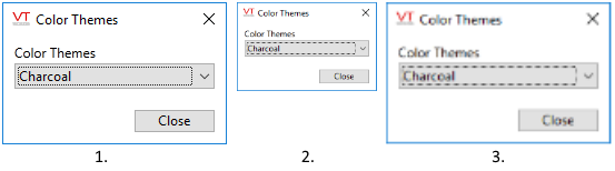

Image scaling using a Paint program. Image 1 shows a VTScada dialog box, full sized. In image 2, the dialog was scaled to fit within a smaller number of pixels. In image 3, that scaled image is viewed at the same size as the original, simulating the effect of scaling to a smaller resolution on an equivalently sized monitor. The loss of detail is readily apparent.

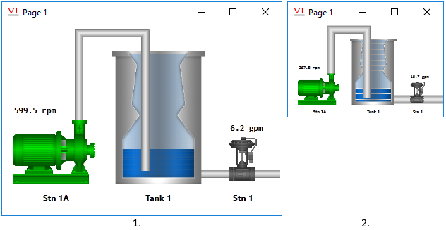

Image scaling within VTScada. Image 1 shows a typical detail, full-sized. In image 2, the page was configured with the Scaled to Fit option and the page size reduced to approximately half the width and half the height in terms of pixels. This is equivalent to viewing the page on a monitor with a lower resolution. Image degradation is apparent in the text and all the widgets.
